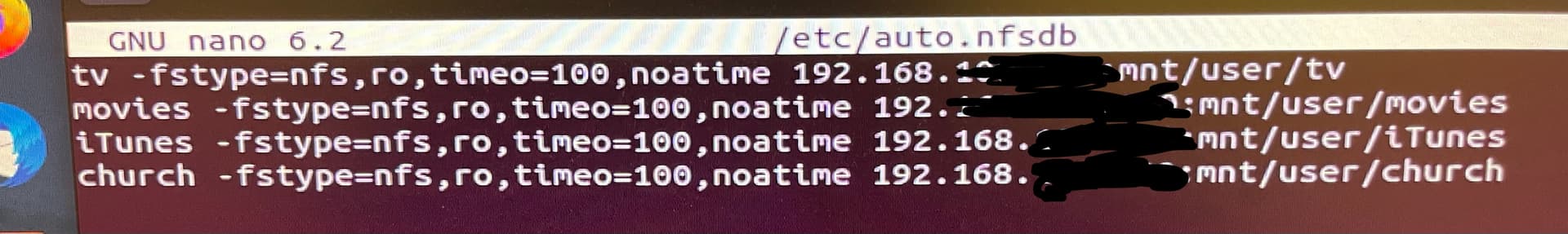

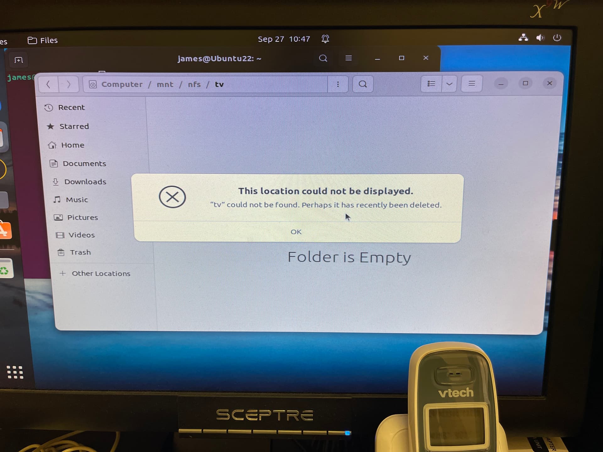

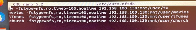

I’m a nubee. I had to reinstall Ubuntu as my previous system was acting up. After installing a fresh copy I followed the steps here to automount files. I have all my media on Unraid server and am using Ubuntu to transcode as jdm suggested. For some reason the nfs folders mounted but when I access the folders on ubuntu it says “location cannot be displayed. ‘tv’ could not be found.” I believe my permission in Unraid are ok as I didn’t change anything there. I did rename user name on ubuntu, but I matched it a user on unraid as well. Any help would be greatly appreciated.
Please share your AutoFS config.
Is this what you mean?
There’s no reason to hide local IPs. Share the entire screenshot so that we can make sure formatting is correct.

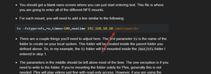

TL;DR : your paths are wrong.
your paths are missing the preceding / after the :
so
:/mnt/user/tv
:/mnt/user/movies
:/mnt/user/iTunes
etc
From Step 1
Thank you! Two eyes are better than one.

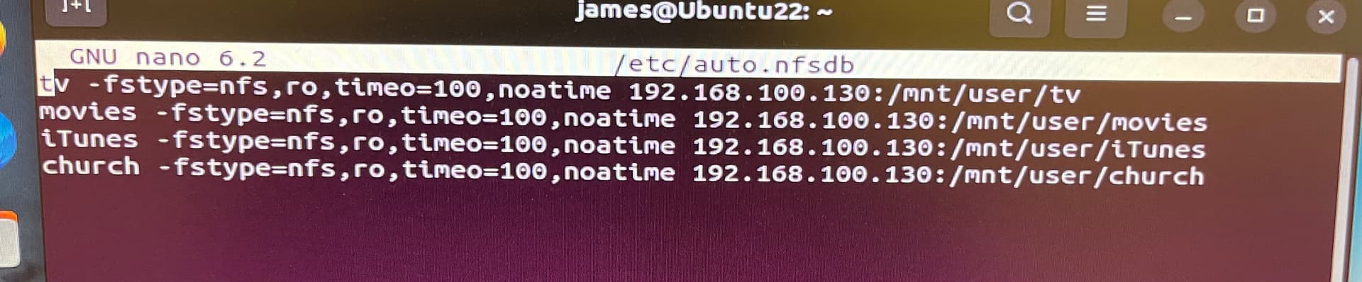

Here is my new config. However I’m still getting the following message on Ubuntu.
Have you rebooted?
Yes I have. Both unraid and Ubuntu.

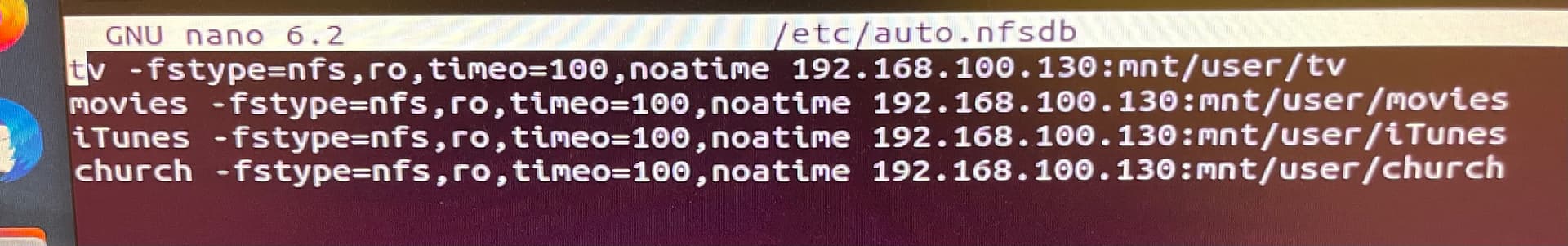

Thank you so much for all your help thus far. The only thing I can think of that I did not do was the mkdir command. Is that necessary? If so, how to do it? I see that there is already a folder labeled “nfs” with the tv,movies, etc as subfolders. Is this sufficient. I wonder if the problem is Ubuntu 22.04.
Why would you skip something in the directions?
Can’t mount a remote to a local directory that doesn’t exist
So this is where I’m confused.

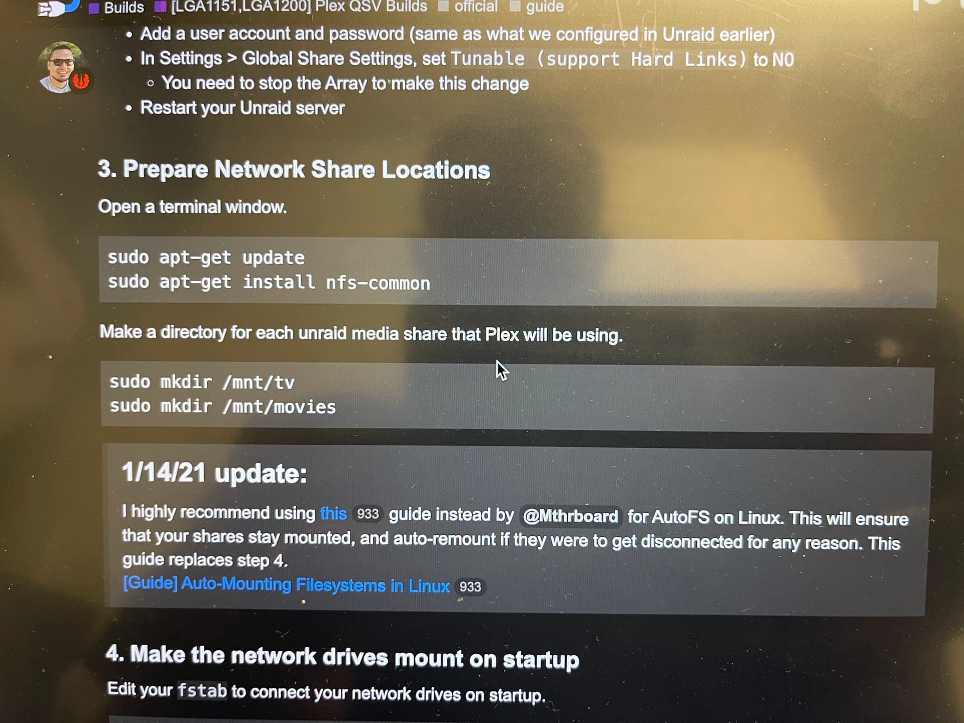

If I’m using the 1/14/21 update. What directories do make before proceeding? Also, I don’t need to do the fstab setup correct?
Thanks for your patience. Greatly appreciate it.
Thank you all! I figured it out. My path for autofs was missing “media” - so it should be /mnt/user/media/tv
